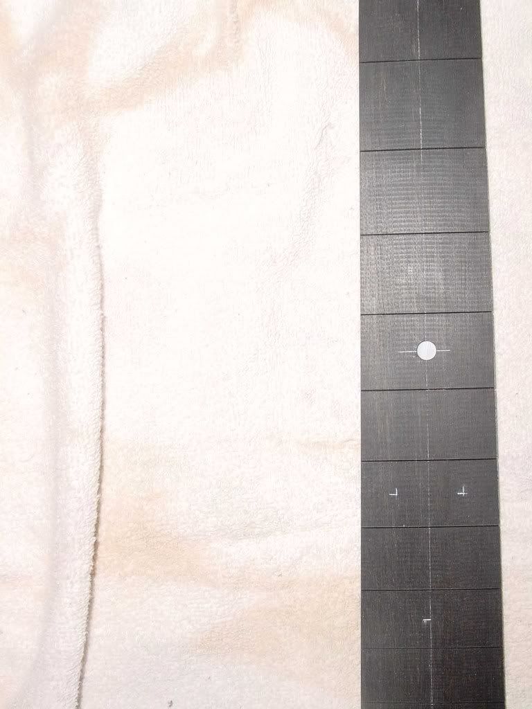

Hello All,
while attempting to prepare an inlay for a pearl dot on the fretboard, I bumped the dremel as I
was trying to turn it off. This of course caused a slight gouge. (I wont make that mistake again)
I was supposed to just have to use a brad point drill bit to create the cavity for the pearl
dot. For some reason, this dot that goes between 4th and 5th fret measures 7mm. I’ve tried many
times in the past to find drill bits sized in millimeters locally to no avail. Much less a brad point.
As for the rest of the dots, no problem. I have the bits for them.
Anyway, I thought I would give it try, and router a circle for the dot. I needed the practice,
since I plan on inlaying the peg head with a custom made inlay.
So, though it’s a very, very small area, I’m sure it will need to be filled.
What do you all like to use when you’re filling an Ebony fretboard around a white pearl dot?
Thanks for listening,
Robert
Here's a couple of pics of the fretboard and dot.
What the pics don't show is the router went ever so slightly outside of the desired cut, which I
believe also necessitates the need for filling.
And, as you can see, (or least I think you can see), the gouge is very small.

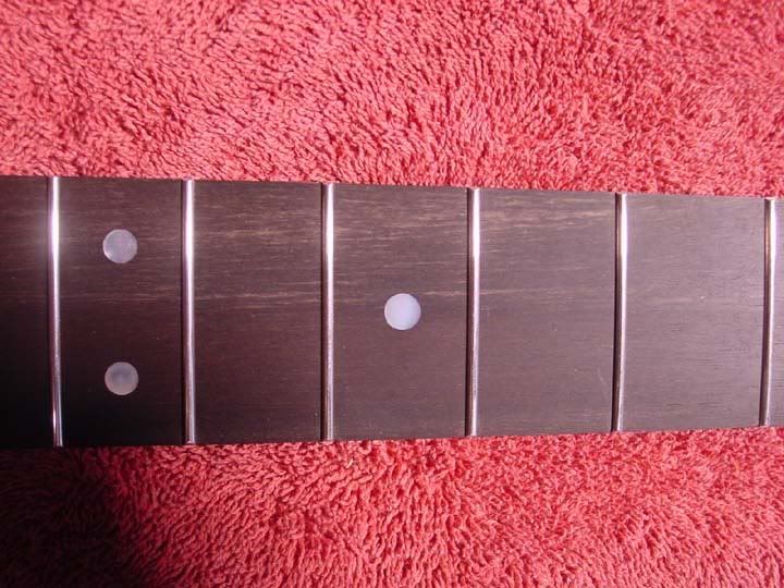

Thanks to all your advise, the pearl dot mishap has been resolved!
Martin and Ron, I combined your methods. I made a mixture of CA and Ebony dust to a pasty
consistency. I’m very pleased with the way it looks.
Thanks again, Robert
Before
After

Paul, Thank you so much for your advise. However, I’d like to tell you, that it worked very well.
This is what I did;
I took a small pile of ebony dust,(about a 1/4" high, and ?" wide) placed it on my marble slab.
Put one drop of CA (Superglue?), then mixed it rapidly for approximately 15 seconds, then very quickly
placed it into the divot, and cracks. This took about 20 seconds. After roughly 2 minutes it was
ready for shaping and sanding. I’d say that the whole process took about 10 to 15 minutes to complete.
In fact, it worked so well, that I tried it a second time filling around some of the other dots.
